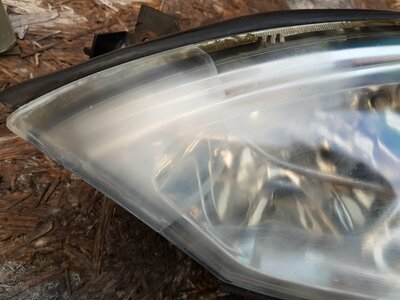

Both headlights need rubbing down and brightening up. So that's part of the same job. Although I noticed that one of them has moisture in by way of condensation, its threatening to ruin the silver dip coating ( that doesn't actually do anything except look pretty ). I managed to get that lamp out and to the greenhouse where it was dry by the time I cleared up tonight. I assume it is due to heating during the day and sucking in cold damp air at night. Not sure how I could test them for airtightness without risking getting water in. Pumping them up and holding them under the hottub seems a bit risky.

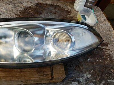

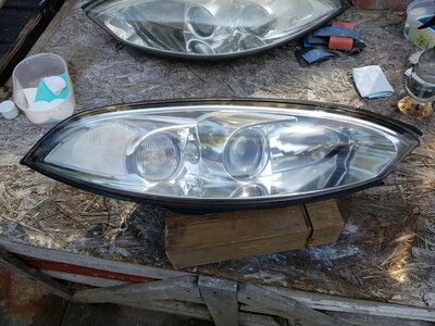

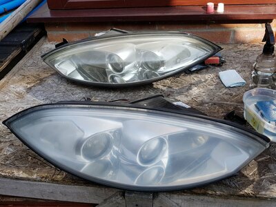

Not much progress today. I was going over the Wife's Vectra for the MOT tomorrow. One little snag, there was a thin slice of tyre sidewall dangling down, where the wheel had been kerbed. Nothing that would materially affect the strength of the tyre, but hanging there it was going to attract attention. I spent ages trying to glue it back in place so as it didn't notice - but it did. However, I challenge him to pull it off, I used professional chemical buffer and vulcanising cement - see Rema 'Tip Top' products. I need to find a muddy farmyard before the morning...

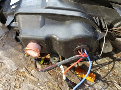

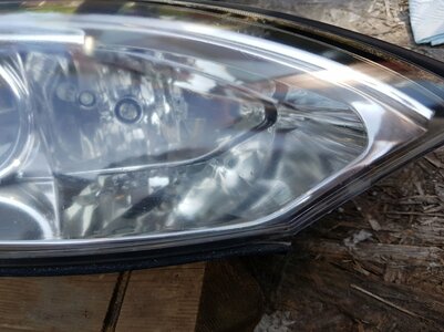

However, the moisture in the headlights. I thought I'd dried this out, but when I came to move it, it ran 'round to the front glass. So I carefully put that one back to bake a bit more. Moving to the other one I examined the little 'reservoir' below the lenses where it seems to settle, that one was dry. Then I found a possible cause, the wiring on the back, or at least where it should perhaps be routed. It looks like the grey plug was originally in the rear cover, that leaves a 1" diameter hole ( which unfortunately you can't see in the photo ).
I'll look at tidying that up before I refit it and maybe mount that 'CANBUS' resistor in a better place, or maybe even get rid of it. I have made progress with the 'Bulb Failure Module' that I got from Chris' Tiger. When I get a moment I will update that thread with some photos so you can see what I found.

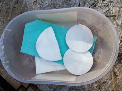

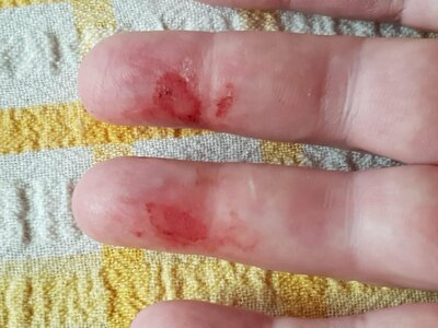

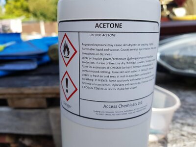

I then broke out the wire wool and started to rub the lens down. This was going quite nicely at first, probably beacause I went for the yellowed area first. I found that as I moved further down the lens, that the existing coating was incredibly tough to remove. Whether this is an original coating or a previous refurb I'm not sure. I'll probably change over to 'Wet & Dry' tomorrow if I get a chance...
