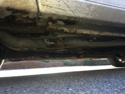

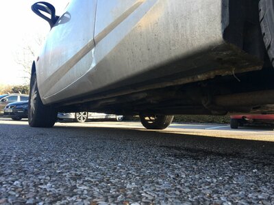

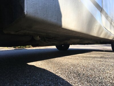

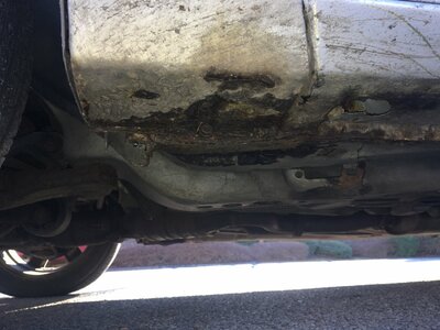

Just looking at the list alone we've seen much worse coming back from that around here ...do you have any pictures of the rot on the outer sills?
The fail on the front suspension where is that Rust?

Likely it is fixable but might cost more than the car is worth, unless you can do your own sill repairs. And you'd get more selling the spares than selling to the scrappy.
Keep in mind that "prescribed area" is 30cm from any suspension/subframe mounting point, so this doesn't necessarily mean your subframe bolts are rattling around in a rusty hole - it could be (and probably is) inner or outer sill underneath the front of the doors.
Another solid vote here for "get some daylight pics and let's see what's what".

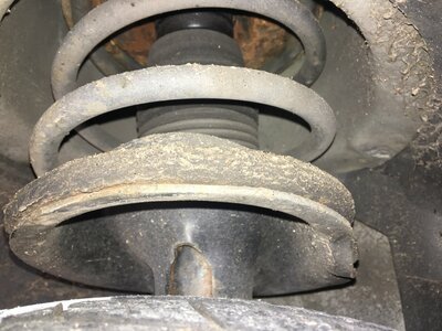

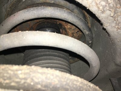

Incidentally, I'd love to know what those top two advisories are all about - you can't see the upper mount with the strut in place. Anyone?
You can kind of see it with the strut in place but not enough to make a proper assement of it
That's what I was thinking, Dan. The only thing I can assume is that the lower part of the mount (where those two 10mmm go through) is probably a bit crusty which, frankly, isn't the biggest deal in the world.
The only alternative thing would be the outer skin of the turret, as visible in the well. But if that was the case, they'd be a straight-up hard fail, not an advisory.

What are thoughts on the current value of the car as-is? I'm happy to take some pictures to show the condition of the rest of the car, and can try to take some shots of underneath (although don't have access to a ramp).
