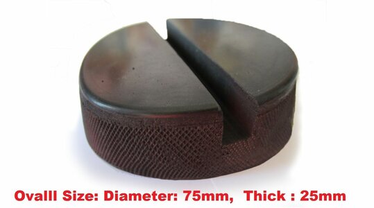

I could do with a new one, my old Lake and Elliott that originally sat in my Hillman Imp is starting to leak. I can also highly recommend using a 'saddle pad' to save the underseal and paintwork. Beware, some of them are not rubber and have no give in them at all, but the slot is great on sills...
I've been using these for years, except i just buy the standard ice hockey pucks and cut the slot in myself. Last one i bought was £1 from the local sports shop. :)As Paul says though, very rarely use the sills for lifting but always stick an axle stand under there with one of these sat on top just to spread the weight for when/if the jack settles.
